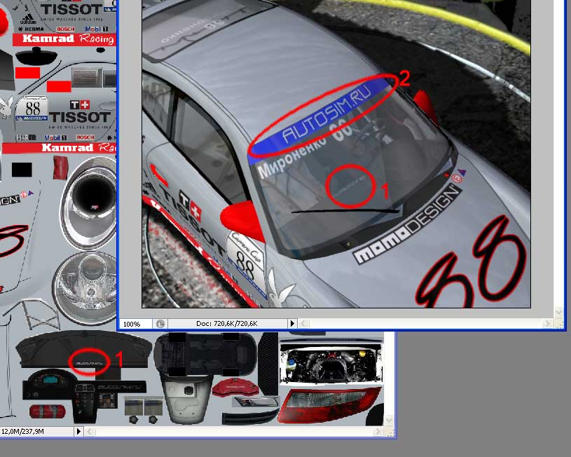

I put the logotype of our championship on the windshield of the car (instead of "Porsche") and on the dashboard inside the cockpit (check the first attached screenshot). It looks fine when watching outside the car - in the showroom or on the track.

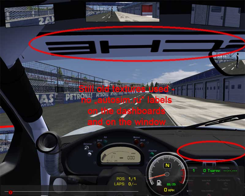

But from the cockpit I can't see those new textures - nothing is on the dashboard and Porsche is on the window.
I suppose, I have to change .dds inside of PCC_997.MAS to make it work. But does it mean that I can't change the textures visible from the cockpit for each car separately?

The Cockpit Textures and Windshield banners are in different textures as the outside ones.
You cannot have for each car seperately cockpit textures. U can only change the textures inside the MAS file but then all car´s use these changed cockpit textures.
